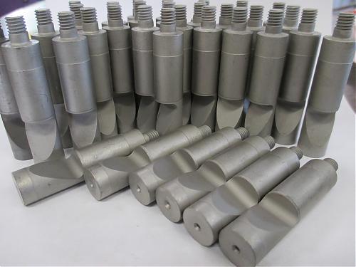

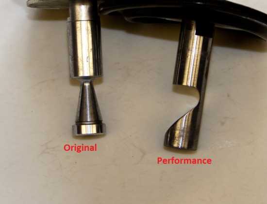

Hello everyone.
Have read that by replacing this rod in the fuel pump can raise the power of 2.5TD engine with about 20HP.
Someone on the forum who have tried this?
Many people in Sweden who have tried with positive results. :woohoo:

I can imagine that a rod of this type and a spring with less resistance can make a difference on a car without a turbo. Turbo is nice! :drive1:
Fuel curve is controlled by the # 4 and # 9.
Check this out www.306oc.co.uk/forum/showthread.php?tid=131&pid=90467

I have contacted a gentleman here in Sweden that manufactures custom parts.However, I have not received any reply from him yet.
Dem ser ut så här
:daumen2:

Them in the picture cost 800sek (90eur)
Availability, I have not received any reply from him.
The same type of stick is also mounted in for example wolksvagen.
The stick is originally from Bosch VP pumps for industrial use.

The stick is available here. www.autostable.se/motortrim/optimeringsl...ar/dt-piston-1833317 Very expensive unfortunately.. €370 :1435:

I've found a cheap stick..
www.brickwerks.co.uk/index.php/ve-boost-pin.html
But it looks just like the original. I'll make some calls tomorrow and sort this out.

This stick can be ordered from
www.dieselmeken.se/
Cost 800sek (around €90)
Only works on a turbocharged engine.
More power to the Kult-Wohnmobil :daumen2:
